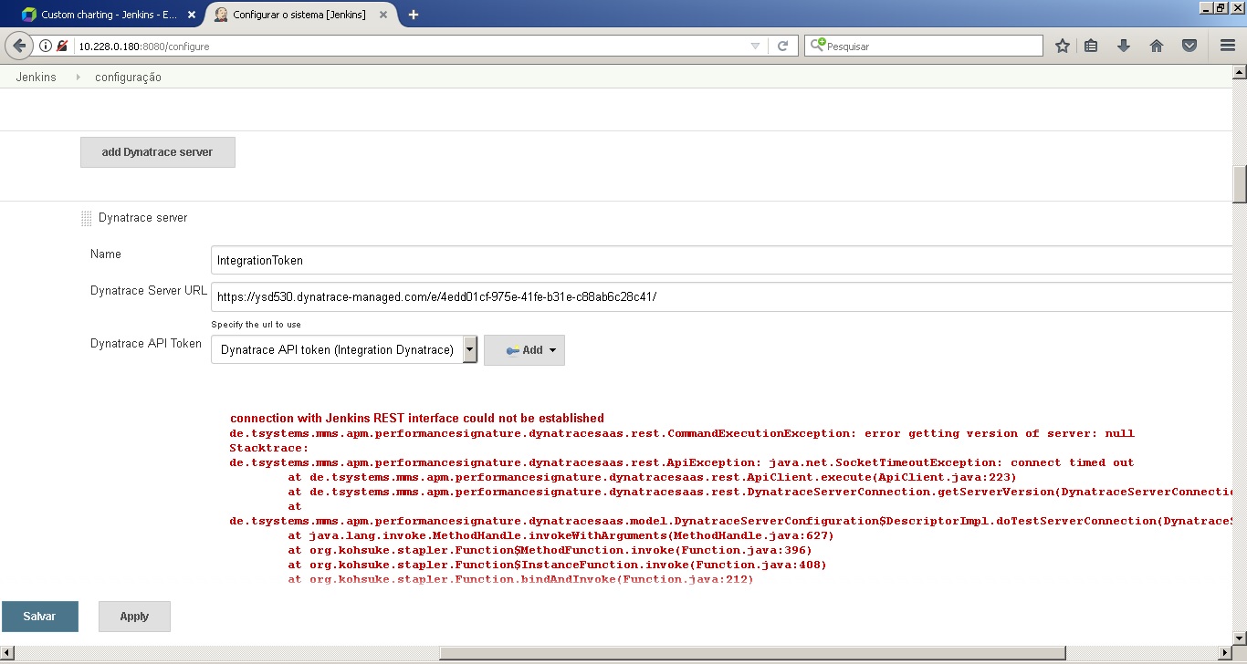

I have a problem with the integration jenkins and dynatrace.
This error: Connection to the Jenkins REST interface could not be established occurs when I try to push the test data.
Log file:
de.tsystems.mms.apm.performancesignature.dynatracesaas.rest.CommandExecutionException: error getting version of server: null
Stacktrace:
de.tsystems.mms.apm.performancesignature.dynatracesaas.rest.ApiException: java.net.SocketTimeoutException: connect timed out
at de.tsystems.mms.apm.performancesignature.dynatracesaas.rest.ApiClient.execute(ApiClient.java:223)
at de.tsystems.mms.apm.performancesignature.dynatracesaas.rest.DynatraceServerConnection.getServerVersion(DynatraceServerConnection.java:90)
at
regards
Roberto Lopes

Hi All. A Connection TImeout indicates that your Jenkins Instance is not able to open a network connection to that Dynatrace Server URI Endpoint. I would logon to that machine where Jenkins runs and try a CURL to validate that there is no firewall blocking Jenkins from accessing this URL

Per our conversation, the exact error I am seeing is due to the jenkins plugin being meant for the new generation of the Dynatrace APM, and in our older instance it is not compatible
