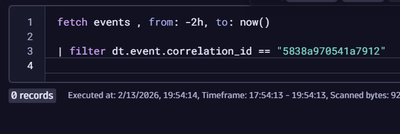

I am sending a CUSTOM_INFO event using the Dynatrace Events Ingest API. The API call responds with Status OK.
However, when I try to fetch the same event in Notebooks using DQL, it Zero results.

100 568 100 91 100 477 220 1154 --:--:-- --:--:-- --:--:-- 1378{"reportCount":1,"eventIngestResults":[{"correlationId":"5838a970541a7912","status":"OK"}]}

The correlation ID you got from POST result is not the same value as dt.event.correlation_id. Also, the event.kind property is a default Dynatrace field, and you will not be able to adds custom values to it, same goes to the field event.type.
Try to filter by the event name (title).
fetch events
| filter event.name == "validation.triggered"try and let us know.
17 Feb 2026 04:33 PM
Thanks @dannemca ,
I can see the event with above mentioned filter.
