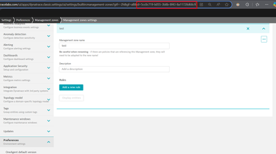

Hello Sajarra.
If you head over to the management zone settings (Settings > Preferences > Management Zones > Management Zones Settings) and expand one of the management zones, you'll be able to see the ID.
Hope this helps!
