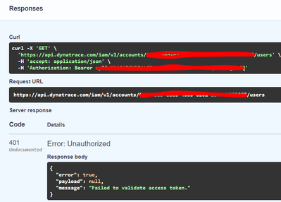

But when I try to get information about the users I get HTTP 401 Unauthorized error:
I get the same error if I lauch this request using swagger:
Does anyone know what is missing?

When creating the OAuth client, you set all the required scope in UI. Then you will get the client_id, client_secret and resource.
You then use these values in your POST request to get the access_token, which is a really long string. No need to set the scopes again there.
Make sure to copy the entire string from "access_token" value in result json.
From your screenshot, seems you are copying just part of it.
Can you confirm and let us know?

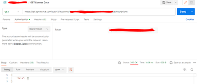

It's very strange. Using the same bearer, if I launch this request
curl -X 'GET' \  'https://api.dynatrace.com/sub/v2/accounts/xxxxxxxxxxxxxxxxxxx/subscriptions' \  -H 'accept: application/json' \  -H 'Authorization: Bearer MY_BEARER
to view my suscriptions, I get HTTP 200 OK but no data is returned:
This is the scope defined:
account-idm-read account-idm-write account-env-read account-env-write account-uac-read account-uac-write iam-policies-management iam:policies:write iam:policies:read iam:bindings:write iam:bindings:read iam:effective-permissions:read app-engine:apps:run settings:objects:read settings:objects:write settings:schemas:read oauth2:clients:manage
Thanks.
