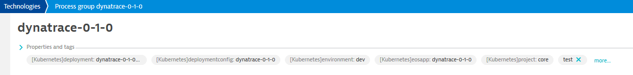

So actually I have the same usecase as described in the blog post. I want to merge all springboot REST-Services of one springboot deployment. In my example I have this Process Group which is equal to my springboot application:

Ah now it works. In the last try I had a copy paste error. I added the context to the tag correctly but missed to remove it from the name.
So this solution now works to merge all web services into one web request service for the given process group:
  "type": "FULL_WEB_SERVICE",
  "name": "dynatrace service",
  "description": "merge resources of dynatrace service",
  "enabled": true,
  "detectAsWebRequestService": true,
  "conditions": [
      "attributeType": "PG_TAG",
      "compareOperations": [
          "type": "TAG",
          "tags": [
      "context": "KUBERNETES",
      "key": "eosapp",
      "value": "dynatrace-0-1-0"
