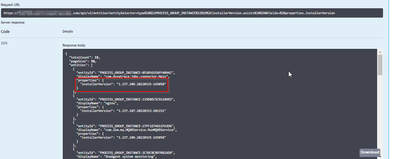

It looks like the specific property will be on a process group instance entity and is called "installerVersion."
So your selector would be to retrieve process group instances or a specific entityId of a PGI:
entityId("PROCESS_GROUP_INSTANCE-XXXXXXXXXX") or type("PROCESS_GROUP_INSTANCE")
or to make sure you only pull ones deeply monitored that would have that value:
type("PROCESS_GROUP_INSTANCE"),installerVersion.exists()
and the 'fields' would be:
+properties.installerVersion or +properties (for all props)
thank you so much .

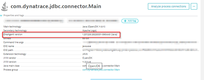

But I'm going to ask something just to be sure. Is the version shown with this OneAgent versions in processes or hosts?
Hi @kadirhan,
that should refer to the OneAgent version.
Best,
Mark
