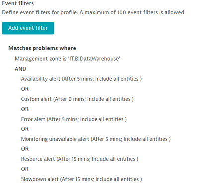

but I cannot figure out how to get the event filters:

The settings schema you are using is for problem notifications. Alerting profiles is the schema you need (builtin:alerting.profile). When you pull the alerting profiles, the payload has a section called "eventFilters" which will have the information you want!
