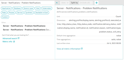

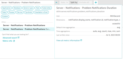

Hi @Theodore_x86 & @dannemca
Maybe Server - Notifications - Problem Notifications metrics can help you a bit?
Yos
04 Jul 2023 11:29 AM
Thanks a lot Yosi, I will try the metric and see if it helps for our case.
04 Jul 2023 01:06 PM
It does help, @Yosi_Neuman , but when you want to see the notification/profile status only. If you have many problems happening in the same timeframe, it gets hard to check the status for those individually. So the Idea I posted suggest to include the ProblemID as dimension to this metric.
