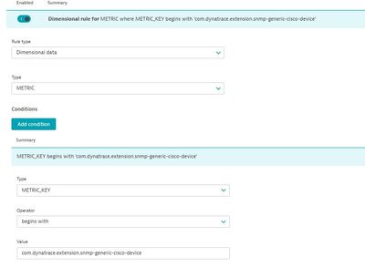

Hello Malaik,
If you’re looking to grant dashboard access for a specific extension, you need to add the extension metrics used in the dashboard to the Management Zone, not the extension itself.
For example, if you want a team to view data from the Generic Cisco Device extension on an existing dashboard, or build a customized dashboard, you can include the relevant Cisco metrics in that Management Zone rule set, as shown in the screenshot below.
