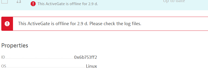

Hi there @Radoslaw_Szulgo , I understand that this is an old thread, but I'm currently having a similar issue with the "old" EAG being unable to be accessed, can I get a confirmation that this 7 days of inactivity is referring to this message on the CMC Deployment status?inaccessible EAG showing offlineinaccessible EAG showing offline

Is there any way to clear it before the 7 days retention period ?
Unfortunately, it's not possible currently.
