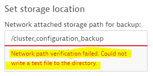

Babar_Qayyum
Hello @Radoslaw S. @Július L. @Chad T. @Malik R.
According to the documentation, 'The user running Dynatrace services needs read/write permissions for the shared file system.' If I am not wrong, by default the services are running with the user dynatrace. Is my understanding correct?
The user dynatrace has full permisssion on the shared file system, but I am getting the below issue.
Regards,
Babar

pls paste `ls -la` so I could see how it looks like with perms
Senior Product Manager,
Dynatrace Managed expert
Hello @Radoslaw S.
Please find the below information.
I am getting the permission deniced with the root user while using the command ls -la
Regards,
Babar

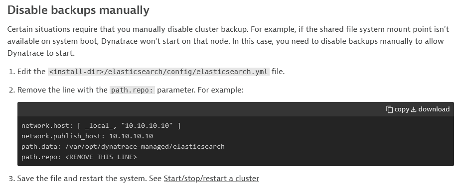

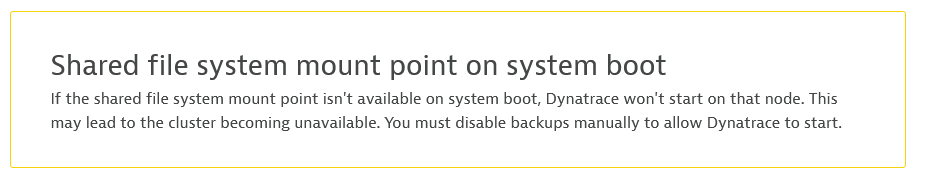

AntonioSousa
In the documentation the following appears:
https://www.dynatrace.com/support/help/managed-cluster/operation/back-up-and-restore-a-cluster
In this case, we have to disable backups manually. It's explained in the bottom of the page how it's done:
Antonio Sousa
