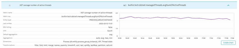

Hello,
Thanks for confirming this. I was trying to see if there was any workaround, as the client asked if he could see the number of waiting or active threads per service.
Just fyi i figured out a workaround in AKS so i thought i share it for future reference.
In AKS each service can run on multiple pods, so if you filter the .NET average number of active threads by process group and then search a specific service you have in mind you will see it. In AKS process and service can be somewhat the same. So based on that you can find it using the below screenshot.
