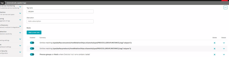

Issue: If you use Apache KAFKA extension maybe you would attach the producers, consumers and topics to MZ for filtering purposes.
How to add producers, consumers and topics to an MZ? with tags. You should create a tag for the process and its producers and consumers.

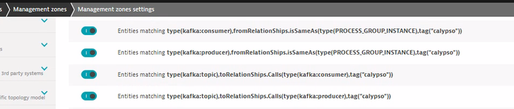

An then add these entity selectors to your MZ:

yes thanks for this.
I was using the same approach for DB extension.  the same approach can be applied to almost any Dynatrace HUB 2.0 extension.  The draw back is that sometimes your hostnames don't have a nice pattern themselves.
