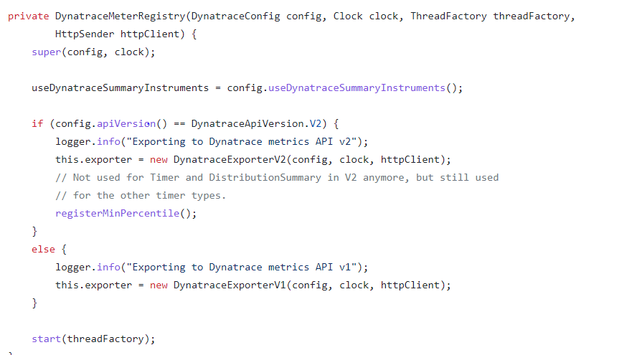

I recommend checking out the Dynatrace Meter Registry source code. It provides a lot of interesting insight on how Micrometer sends metrics to the API. For example there are two exporters that correlate to the two API versions.
Dynatrace Meter Registry code

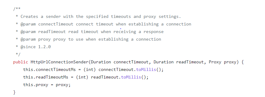

Taking a look at the Dynatrace Meter Registry Builder object you can see the HttpUrlConnectionSender() method. This is used to configure your organization's proxy server on the registry. This method uses a unique Micrometer interface called HttpSender which enables build REST communication for Micrometer metrics.
Let's take a look...
Here you can see that we a Proxy parameter.
So you'll want to create a Bean method that builds a proxy-based Meter Registry. Furthermore, you'll want to obtain those proxy parameters via property files using the "@Value" parameter annotation.
