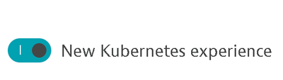

  • Settings (Classic) → Cloud and Virtualization, and within that menu, enable the option for the New Kubernetes Experience. DON’T FORGET TO SAVE CHANGES
This step ensures that the tenant is configured to support the latest Kubernetes monitoring features, which are essential for following the rest of the guide effectively.

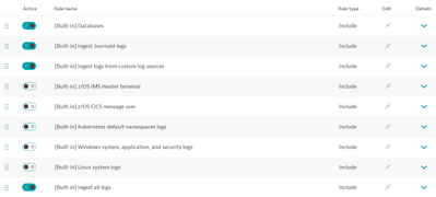

  • Settings (Classic) → Log Monitoring
Within this menu, enable the options you’ll need. If you're working with a large volume of data, you can activate additional log ingestion rules to capture more information. Keep in mind that enabling more rules will significantly increase license consumption in a real-world scenario. Don’t forget to save your changes before exiting the menu.

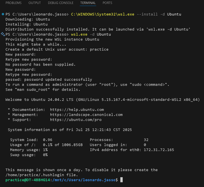

  1. A VM for Ubuntu
For this exercise, it is recommended to create a virtual machine (VM) with at least 4 CPU cores and run a Linux-based Kubernetes cluster on it.

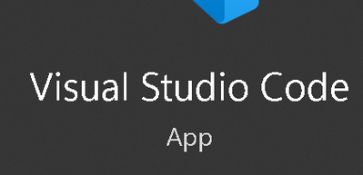

A useful tip for this setup is to install Visual Studio Code (VS Code).
Once installed and running, follow these steps:
  1. Open VS Code and go to the Extensions menu.
  2. Search for and install the WSL (Windows Subsystem for Linux) extension.
This extension allows you to use VS Code on Windows to build and interact with Linux-based applications.
  1. Once the extension is installed, a new menu will appear in VS Code.

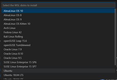

  2. Click on the “+” symbol to add a new Linux distribution.LeonrdoMJ_4-1753806117866.png
  3. In the search bar, a list of available Linux distributions will appear. Select Ubuntu.LeonrdoMJ_5-1753806117868.png
  4. A terminal window will open. Follow the on-screen instructions to complete the installation and access the Ubuntu environment within your VM.LeonrdoMJ_6-1753806117872.png

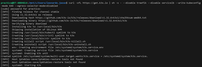

  5. Now we have to install k3s. This way you will have a single node Kubernetes cluster, we have to use this command in the terminal “ curl -sfL https://get.k3s.io | sh -s - --disable traefik --disable servicelb --write-kubeconfig-mode 644 --egress-selector-mode=disabled “LeonrdoMJ_7-1753806117878.png
  6. And with all these steps we are ready to continue with the guide.

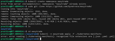

Cloning and applying manifests
While following the guide, there’s some commands,

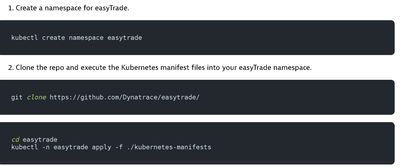

 There’s a tricky part in step 2, particularly with the command kubectl -n easytrade apply -f ./kubernetes-manifests  This command may not work properly, so we’ll need to do some extra steps to make it work correctly.
We will use ls to list all the folders inside the current path. Here, we should see the one we’re looking for: kubernetes-manifests.
Then, we go into that path using cd kubernetes-manifests.
Once inside, we use ls again, and we’ll see three available folders that we can use to fix the original command from the guide.
That means we have three variants of the command to apply the manifests:
  • kubectl -n easytrade apply -f ./base
  • kubectl -n easytrade apply -f ./problem-patterns
  • kubectl -n easytrade apply -f ./release
Once we apply all these new steps using the command kubectl get pods -n easytrade , we will see how many pods are working actually in the implementation
