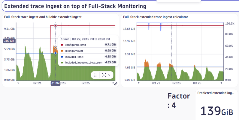

Hi Folks,
At Managed I met these functions at enterprise level. At SaaS DPS maybe the importance of these funtions are more important. Why? There is a limitation of the ingested trace data volume:
https://docs.dynatrace.com/docs/shortlink/dps-hosts#distributed-traces
"Dynatrace provides the ability to extend the amount of trace data ingested with OneAgent. To do this you can request an increased Trace ingest limit beyond the 200 KiB of trace data included per memory-gibibyte."
Because of the 200 KiB of trace data included per memory-gibibyte the Adaptive Traffic Management will be activated if you cross this included limit.
Adaptive Traffic Management with Dynatrace Platform Subscription (DPS) — Dynatrace Docs
Here is an example when ATM is activated. Trace and request capture rate is dropped under 40%.
You can check this at the Full-Stack Adaptive Traffic Management (gen3) dashboard.
On the dashboard you can increase the factor 1.0 to check the missing trace data volume (or predicted extended ingest volume data). You can also check the included limit (calculated based on the full-stack covered memory size) and configured limit (this can be increased by support). Orange area is the dropped data volume and could be the subject of extra ingest costs.
What could be the solution to increase the capture rate of the trace and requests?
1. Exclude unwanted / unnecessary incoming webrequest URLs like /health, /metrics, /actuator and so on. I am still a Managed fan so I checked the candidate web requests in MDA, but you can use DQL also.
2. Exclude unwanted / unnecessary exceptions. You can use also MDA and DQL to find candidates.
3. Raise a support ticket and ask them to increase the factor 1.0 based on the requirements . Of course this should be done after two previous steps. In this case the factor increased from 1.0 to 2.0 and the configured ingest limit increased two times compared the included limit. The subject of extra ingest cost is the data volume which is above the included limit (orange area).
Capture rate is almost 100% again:
4. You can combine the DEV / UAT / PROD in one SaaS environment in order to have a bigger covered memory size. But this solution is maybe not acceptable for many organizations.
+ tip: You can also use the new Distributed Traces app to check the spans ingest sizes:
In Managed clusters the first two steps are also important in order to decrease the required cluster disk space.
I hope it is useful to you.
