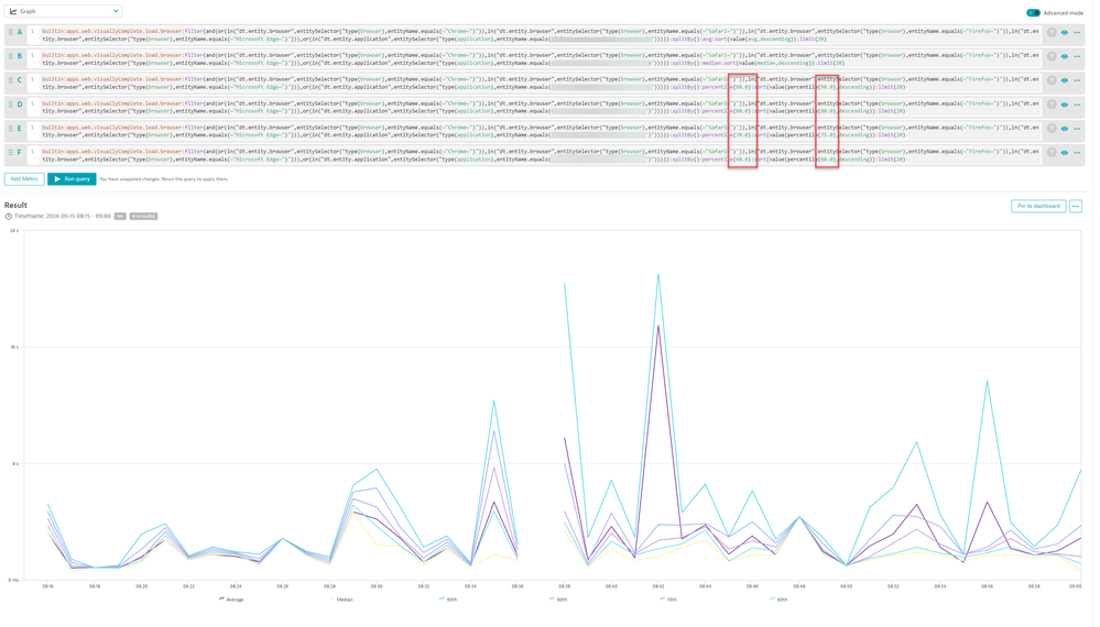

You'll want to navigate to the data explorer, set your metric and the value segment, pick one of the percentiles offered. While you are here you might as well just finish setting your metric query the way you want it. Once your done, click the button in the upper right hand that says "Advanced Mode"

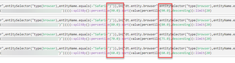

Once in advanced mode take a look for the two locations where your defined percentile is and supply your value:
ChadTurner_1-1715886340454.pngzoomed in:
