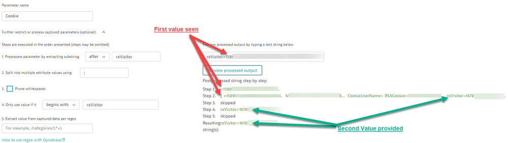

Setting the parsing rules - As mentioned we needed to target the first value for one RA and then the Second value for the Second RA, if and when that value is present. So we attempted to leverage a look ahead method, this regex script grabs the first qualifier of the rxVisitor: rxVisitor=(?=1)[^\-;]*+, but we found that the (?=<Value>) only starts the capture if and when the string starts with your value as defined. So we came up with a clever solution.
First Cookie Present - For the first cookie RA we did in fact use Regex since it will scour the entire cookie header and provide us the value of the entity anywhere in the string, and once its found, it stops and wont return a second. The string we used was: rxVisitor=[^\-;]*+

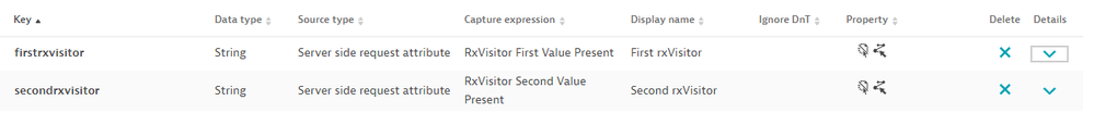

Second Cookie Present - This is where we get clever with the parsing of the data. In step 1 we define out that we want to extract the substring 'After', rxVisitor. That means the first value becomes 123456 rather than the original value of rxValue=123456. Step two we split the data via the ';' since all the key value pairs in the header are separated by that character. Finally we use step 4 where we then further define it via only using the value if it 'begins with' rxVisitor. Which we know the second value will, since we cut off the key value pair of the initial - first seen - rxVisitor Value pair.

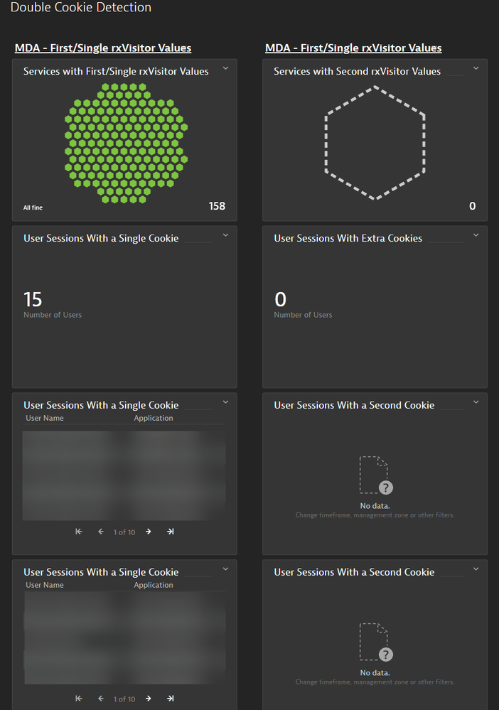

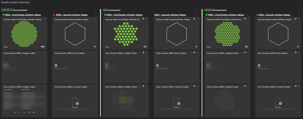

Now that we have the RA's built, you will need to allow them to start to qualify since they are forward facing. While that populated we then formulated a dashboard that is looking at the number of services with a single vs duplicate cookie value we just defined. Taking it a step further, we added the RAs as a session string value and are now able to leverage USLQ and provide user names, actions and associated applications that has two RA's we built present. Keep in mind we are not in a healthy state so the duplication ones are empty but will come alive once detected.
Expanding to User Sessions - This step is quite simple since the RA is built, just go to the desired app and edit the settings > Capturing > Session and Action Properties:
Now user sessions are linked!

Here is the single pane of glass dashboard we developed:
