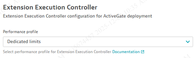

Hello @AntonioSousa & @mike
We are utilizing the performance profile alongside a group of 4 ActiveGates; however, we continue to encounter the following issue (VMware Remote Monitoring). Also, there is no resources issue on any one of the host.
High memory usage detected for python datasource running configuration 723ecea2-82f0-35e5-bd20-a242cd5b0829. Restarting
Regards,
Babar Qayyum
The VMware extension consumes a lot of memory. How many ESXs/VMs?
