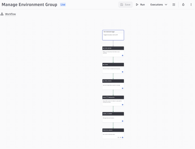

Julius_Loman
DynaMight Legend
DynaMight Legend
Great write-up @Mizső , I have developed a similar, more advanced solution for SaaS using workflows that helps eliminate the restart issues to a significant degree. It is also connected to deployment events from the CI/CD pipelines, sending SDLC events on deployments. So, for example, if part of the environment has to be shut down, deployments enable Dynatrace during deployment and turn it off after deployment is finished. This ensures that the Dynatrace OneAgents are enabled during restarts. This, of course, does not resolve situations of manual restarts of processes when OneAgent is disabled.
  1. I have a common workflow for disabling / enabling part of the environment. Groups (scopes) are defined in lookup tables so we can define multiple parts (dev / test / preprod / uat) independently, currently by host groups and k8s clusters. It takes a few arguments on input:
    • enabled (boolean) - if the workflow should enable or disable
    • group (string) - name of the group to manage
    • trigger (string) - trigger type
      • "manual" - for manual enable/disable (triggers always)
      • "schedule" - for scheduled enable/disable (does not disable if deployment is running)
      • "deployment" - for enable/disable before/after deployment (does not disable after deployment is during business hours)
    • check_restarts (boolean) -o check for restarts
    • send_restart_events (boolean) - if CUSTOM_ALERT events need to be send
  2. Workflow does multiple tasks
    1. Gets host groups to disable from Grail lookup tables
    2. Gets host to be disabled from these groups
    3. Gets k8s clusters for the groups (disable Kubernetes API ingest)
    4. Check if deployment is running (do not disable hosts if deployment is running, another workflow run will disable the environment after deployment finishes)
    5. Disable or enable hosts if conditions match
    6. Check for processes needed to be restarted and raise custom alerts for these processes - depending on the argument.
This workflow is triggered by several other workflows using the API (not a call other workflow type) to optimise workflow cost (otherwise there would be 7 full workflows instead of one):
