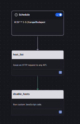

Of course, we used the latest Dynatrace Workflow functionality. Once again, we aimed for the simplest possible solution.
We created four workflows:
  1. Switch off OneAgents on the hosts at a scheduled time.
  2. Switch on OneAgents on the hosts at a scheduled time.
  3. Switch off OneAgents on the hosts on demand, for example, in emergency situations.
  4. Switch on OneAgents on the hosts on demand, for example, in emergency situations.
The workflow itself is very simple.
The first main step collects the host list using an API call. The second main step switches the OneAgents off or on using API calls from a script created with DT Assist.
Here is an example workflow for switch off.
First main step
host_list is a GET API call using the appropriate API token.
https://xxx.live.dynatrace.com/api/v2/entities?entitySelector=type%28%22HOST%22%29&from=now-3d
now-3d can cause a logical problem. For example, you might switch on hosts that you don't actually want to switch on. You can adjust this time range according to your requirements.
Second main step
Use the results from host_list in a script and switch the OneAgents on or off on the selected hosts.
