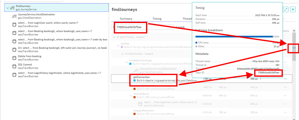

When working with OpenTelemetry or Log Enrichment, you might find yourself with a Span Id that doesn't match the Span Id of the Purepath. If you know that the Span Id is really inside your Purepath, one way you might find it is searching for it in the Code Level section. Just search for the Span Id, and if it's there, Dynatrace will point it out:

Great Tip @AntonioSousa Thanks for Sharing
