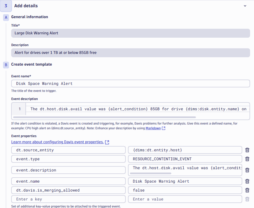

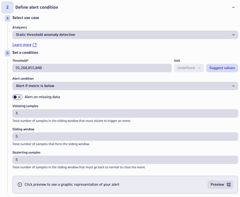

Ok, so that is the query, now, for the DAD, obviously, put the query in the SCOPE, for the alert condition (adjust as needed for your shop) be sure to put the same threshold used in the DQL:
and for the details (again adjust as needed for your shop):
I hope this helps anyone else who is fighting disk space monitoring limitations in Dynatrace.  Please comment with any issues or ideas for improvement.
