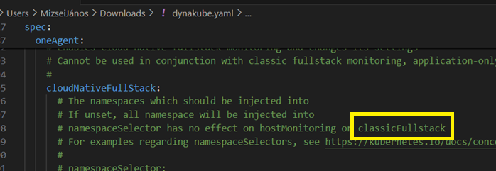

I spent some hours to investigate a dynakube installation error at a client. I was a little bit blind.
During the installation we downloaded the dynakube.yaml from the GUI. The client had a decision that they will use the classicFullStack type.
We made a mistake during the configuration. Unfortunately, we replaced the type from the comments section with a copy.
The type parameter is case sensitive. So calssicFullstack did not work. We had to use classicFullStack. 😉
I hope you will not spend hours with similar investigation in the future.
