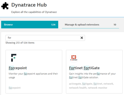

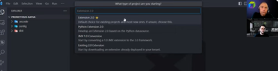

You may follow this video : Dynatrace Extensions 2.0 for Visual Studio Code (youtube.com)
But please choose "Existing 2.0 extension" in minutes 27:
There will be existing extension for Fortinet Fortigate in Dynatrace Hub to be extended into custom extension:
