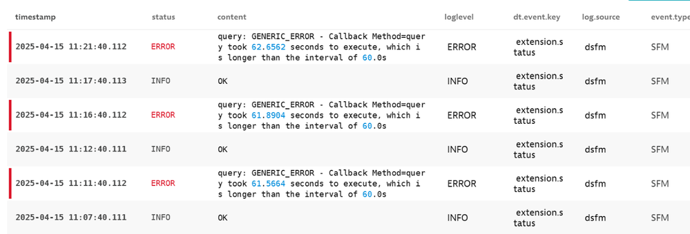

Callback Method=query Python extension error

Is there any possible solution to what is causing the issue, even though I scheduled the query to run every 5 minutes?

Use the schedule method to run it every 5 minutes. The query method runs every minute.
https://dynatrace-extensions.github.io/dt-extensions-python-sdk/api/extension.html#dynatrace_extensi...
