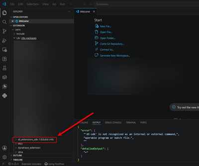

I tried using Dynatrace Extensions: Build in Visual Studio Code, but it produced the following error:
  "error": [
    "'dt-sdk' is not recognized as an internal or external command,",
    "operable program or batch file.",
  "detailedOutput": [
Regards,
AK

You probably need to install dt-extensions-sdk first.
https://dynatrace-extensions.github.io/dt-extensions-python-sdk/guides/installation.html
Alanata a.s.
@rastislav_danis I've installed it and can confirm it's present, yet I'm still getting the same error.
just guessing, but have you tried launching dt-sdk from vscode terminal? is path to this command included in path variable?
