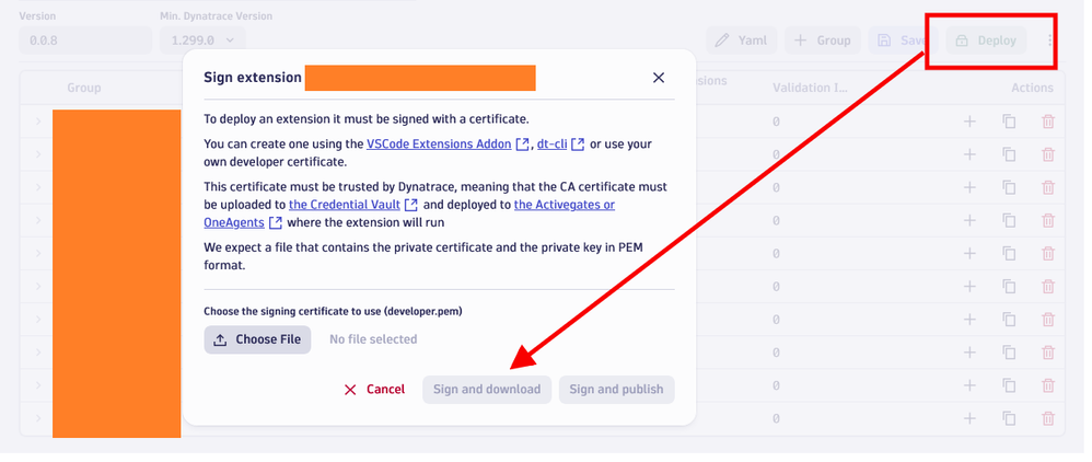

Is there a way to export an extension in its entirety from one environment to import it into another?
The extension was built using the Custom Extension Creator app in a SaaS tenant with Grail, but the client is on Managed, where the app is not available.
AntonioSousa
@andre_vdveen ,
Yes, I do it all the time 🙂
But I export it directly from the Custom Extensions Creator app:
Antonio Sousa
@AntonioSousa I must be blind! :facepalm:😅🤓
