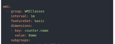

Hello,
In the documentation you can find above example. It shows only the first few lines
The Dimensions, key and value why are they here? Why? Is this a mistake? (-;

Hi Henk,
I think that was maybe inteded as "column:Name" instead of just "Name".
It's at the group level, so it indicates that every metric collected will be split by this dimension, and every query does include the "Name" as a column, so this would be my rationale for thinking it's a typo.

Thanks Radu,
Makes perfect sense (-; Thanks!

Would be nice if the documentation was a bit more extensive. I am also wondering if you can use pretty much all WMI classes as long as the classes are available by the user which executes the plugin.
