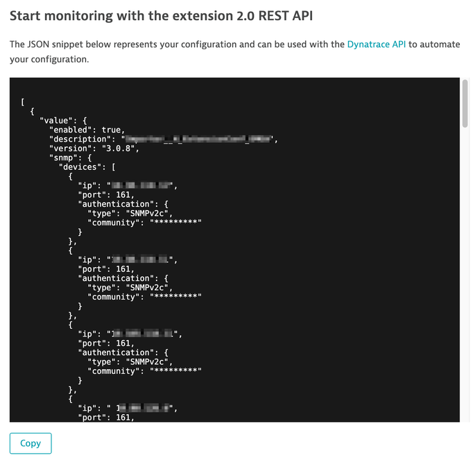

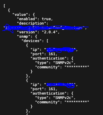

Did you configure it through API or GUI ? Could you share your configuration payload (with anonymized IP of course) ?
Observability Engineer at Phenisys - Dynatrace Professional
Using GUI for configuring the devices.

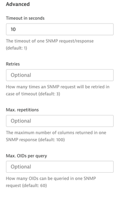

Regarding timeout issue :
  • Try to run snmpwalk from the AG
  • If it works well you can adapt SNMP settings in your configuration:
    • Increase timeout if the device is far away from AG and you have lots of OiD to poll
    • Reduce Max repetitions to 50 if you have an MTU issue (reducing response payload)
