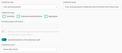

Hi, the documentation refers to external vault integration for e.g., Azure Key vault, but for Synthetic.
Is this type of external vault integration valid for extensions 2.0 too, as there is a tick box for Extension authetication when choosing to sync with an external vault? I can't find anything in the docs about this, although I founds some info on the community that indicates this would be available for v2.0 extensions.
I don't have access to Azure Key vault, otherwise I'd play around and try figure it out myself 😅
Any clarity on this, or possibly even a link to the docs which explains the setup, would be great! 🙂

Sadly is not possible, i suggest you to open a RFE.
