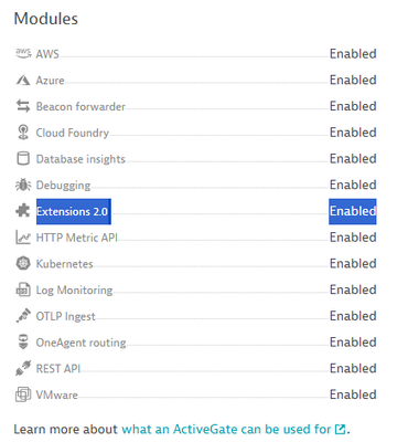

Check your ActiveGate in the Deployment Status. When you collapse the ActiveGate, is the Extensions version available? Also, is under Modules Extensions 2.0 enabled?
Ok I wrote: all extension are active on AG - so YES alle Modules /Extensions are Enabled on  AG server
