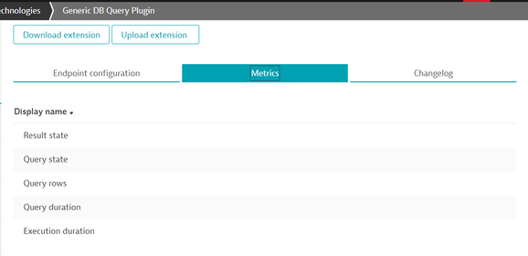

Hi Everyone,
With the DBQuery extension, we're having some issues:

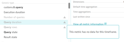

- Only 3 metrics are being logged:
- The other metrics are not returning any data:
- As the extension indicates, it should bring back all metrics:

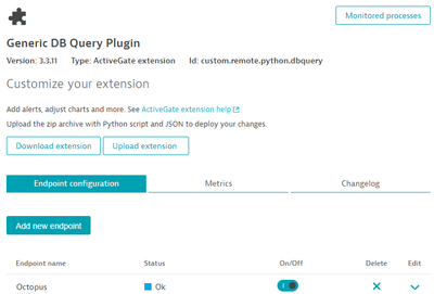

- And its configuration is correct:
Could you help me to what is the cause of this issue?

Probably is because your query is not properly executed in your DBs.
Check the events from your custom devices... you should see the error messages there, if any.
You can also see the logs in your ActiveGates, dir "/var/log/dynatrace/supportarchive/remotepluginmodule/log/remoteplugin/custom.remote.python.dbquery"
12 Jan 2024 06:17 PM
Is this new? This extension is going away and should be migrated to new one. Have you given enough time for it to get data?
This extension is deprecated and will be removed in 2024. Please migrate to the extension framework 2.0 method, described here.
14 Jan 2024 12:39 PM
this v1 extension will be supported till Oct 2024
