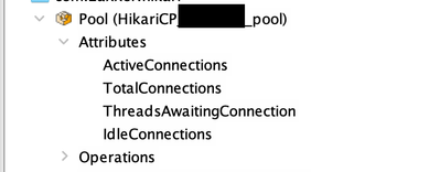

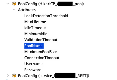

  • com.zaxxer.hikari:type=PoolConfig
There is however an important difference between the two:
  • PoolConfig exposes a PoolName attribute → I can define a dimension (e.g. pool.name) and split metrics per pool
  • Pool does not expose the pool name as an attribute → the pool name only appears in the ObjectName display, not as a key property
Because of this, when multiple Hikari pools run in the same JVM, Dynatrace:
  • collects Pool metrics correctly
  • but aggregates them at JVM level
  • making it impossible to split runtime metrics (ActiveConnections, IdleConnections, etc.) per pool
Example:
  • Pool A: IdleConnections = 2
  • Pool B: IdleConnections = 5
  • Dynatrace reports: IdleConnections = 7 for the same process
This makes per‑pool monitoring and alerting unreliable.
