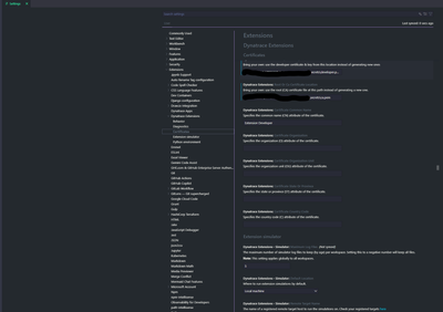

If you dont have the certificate which you are already using, then you can go for the Self signed certificate and get the root and developer certificated stored somewhere local safe and give the location in VS code IDE just like highlighted below, Settings -> Dynatrace Extensions -> Certificates -> "Developer Cert Location" and "Root Cert location" - Please be aware this is one time setup where every time when you build your extension this certificate will be used for sign-in and it will add the certs into the credential vault and you have to add into the AGs in the respective locations
