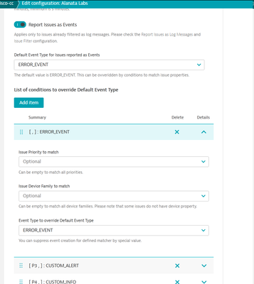

28 Apr 2025 09:14 AM
Hello,
Should there be a problem creation for the events created in Catalyst Center?
I played around with the "Ingest issues as log messages". I see the event now under "loglevel": "ERROR" & "issue.priority": "P1", but no problem created.
I think it might be handy to have problem creation on those issues by default.
20 May 2025 10:23 AM
There is a planned Opt-In feature to report Catalyst Issues as Events too.
