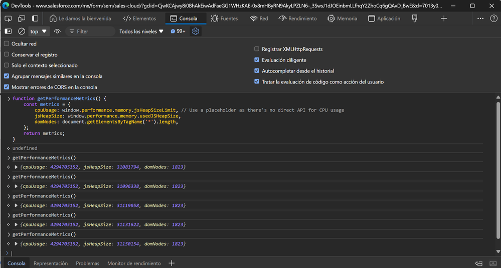

I understand that you're looking to obtain resource usage metrics for your Salesforce webpage from Performance Monitor Tool, such as:
My recommendations are:
function getPerformanceMetrics() {
const metrics = {
cpuUsage: window.performance.memory.jsHeapSizeLimit, // Use a placeholder as there's no direct API for CPU usage
jsHeapSize: window.performance.memory.usedJSHeapSize,
domNodes: document.getElementsByTagName('*').length,
return metrics;

hi @rseibert1
I hope my answer was helpful.
