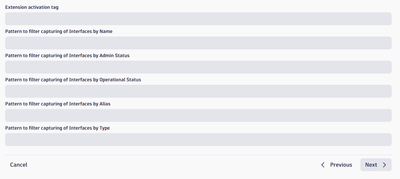

For lowering metric ingestion & process costs one option would be to use filters for Interfaces . In a ideal scenario not all interfaces on a switch or a router might need to be monitored . You can limit the monitoring to only critical interfaces like the WAN links or any other critical links only rather than monitoring all the ports . If your interfaces has good descriptions set you can use the ifAlias as well to filter.

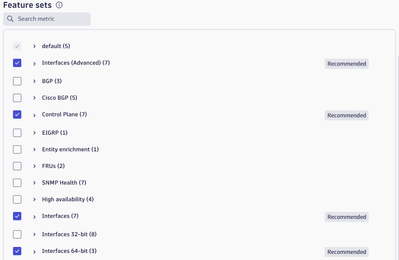

Other option would be to enable only the feature sets that you are interested in collecting the data for , do not enable all of the available feature sets

- Disable any feature sets you're not actively using — only the 'default' feature set is mandatory, everything else is opt-in.
- Check whether any 64-bit interface counters are enabled alongside 32-bit ones that can double up metrics unnecessarily if both are active.
