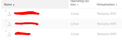

How are you monitoring Nutanix infraestructure? Have you using a Dynatrace extension for Nutanix or is it a custom extension made in Python?
By default Dynatrace recognizes the hosts virtualized with Nutanix AHV.
(The hosts on my environment are swithed-off nowdays).
Then, you can add to your environment Nutanix cluster extension providing the Prism API URL.
And you have to select an ActiveGate that belong to an ActiveGate group.
