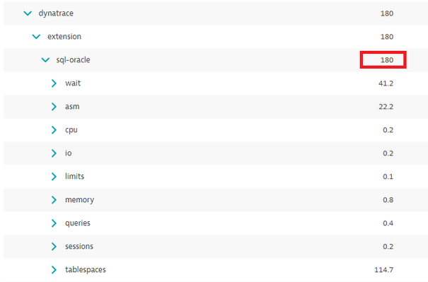

Example for one hour consumption for a quite big consolidated Oracle db by feature sets:

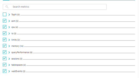

You can swith on / switch of feature sets in the Oracle extension configuration:
