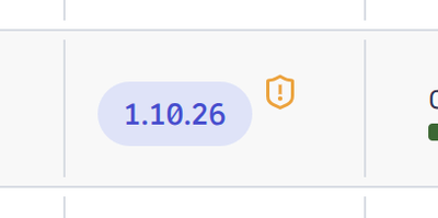

In your documentation you mention the affected extension versions will include a shield icon with exclamation mark, screenshots and references seems to be referring to SaaS. How this will be presented in Managed?

Where can i check as dynatrace user whether the extension i use (oracle, mssql, mariadb) are or are not python based.
@Gramblicka-DXC None of these use Python.  If an extension has to be upgraded for Python, it's shown with a small icon near the version in the Extensions app.
Also a global banner is displayed in the Extension app if any of the extension in the environment uses old Python 3.10.
