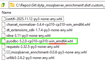

It seems OK. Please check in extension.zip if the pyodbc wheel is included?

You can get anywhere you want, we do it for plenty of extensions.
As you can see on the screenshot that you highlighted you have pyodbc for windows, that will never work on a linux AG.
You need to either build on the same architecture or use the --extra-platform flag when building
And of course you don't really need to mess with this because we have a SQL datasource, that can connect to any database using JDBC.
@david_lopes .
From @chris_cho details, it's clear he has a Linux AG. But, if it were a Windows AG, it would work, right?
Antonio Sousa
Yes sorry, good catch!
I forgot the word linux there, fixing it.

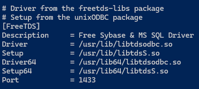

Besides, connecting to MS SQL Server, pypyodbc needs to install FreeTDS (Tabular Data Stream), included in /etc/odbcinst.ini
./setup.py
I used it, but now I am getting another exception message:
('01000', "[01000] [unixODBC][Driver Manager]Can't open lib '/usr/lib64/libtdsodbc.so' : file not found")
Perhaps I need to move FreeTDS to extras_require in the ./setup.py file.
