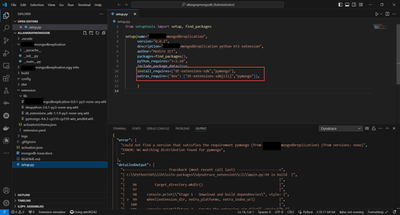

I am busy migrating one of the Python v 1 plugins to V2. As part of the packages I need to upload I use pymongo (https://pypi.org/project/pymongo/) but it is failing with

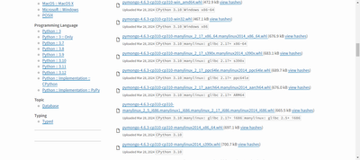

All the packages are there as seen in the lib directory and the setup is showing what is required. The issue seems to be with that because I am compiling from my windows machine it is only downloading the pymongo-4.6.3-cp310-cp310-win_amd64.whl. My activegates are windows so in this case all I need is it to upload this package to the environments.

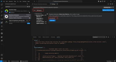

I tried adding just win_amd_64 to see if that work and still fails.

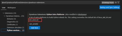

In your second screenshot it looks like the correct one is win_amd64, while you entered win_amd_64 in the third screenshot. Can you adjust it and see if it works?
10 Apr 2024 02:57 PM
@Mike_L Thank you so much. That did the trick. Maybe the team can update the comment as I copied it from there.
