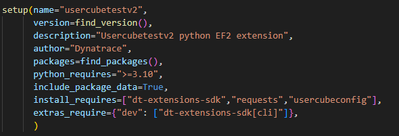

MY setup.file :
I have no problem locally. Please help me.

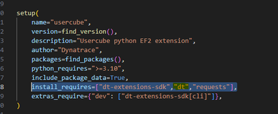

I added ‘dt’ to the setup and my extension works fine.
