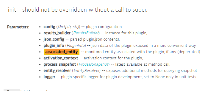

So I am currently using associated_entity to get the entity of a MSSQL database of which I am creating a plugin:
self.entity = kwargs["associated_entity"]
instance_name = self.entity.properties['mssql_instance_name']
However I see that this is deprecated:
What is the recommendation to use instead?

Use activation_context instead, such as this:
kwargs['activation_context'].value.processes[0].properties['mssql_instance_name']
