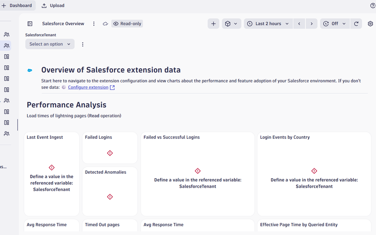

Does it make sense to configure both type of Event Streaming from SalesForce? Current configuration is OpenKit. Client could setup a new custom application with user sessions, but the extension related Business Event dashboard is empty...
Business events dashboard.
Thanks in adavance.

Yes, from my experience, they are mutually exclusive inside the same monitoring configuration...
The BizEvents dashboard will only be populated after setting up at least a monitoring configuration with the BizEvents streaming selected.
So, in order to have BizEvents, you have to let go of the User Sessions on that same monitoring config...
I don't think I ever tried it with both streaming options at the same time (each streaming option on its individual monitoring configuration), though... but it might be interesting!
Just beware that it should reach Salesforce twice, one for each config

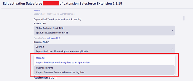

It seems the "double" configuration works fine. We have RUM sessions and BizEvents also.
Now in UAT systems we have 2 config for salesforce endoints:
- First reporting mode is BizEvents + LOGs
- Second reporting mode is OpenKit (for DEM) without log section (same as in the previous)
We will test this configuration in the coming days...

Hi @SanketBhapkar,
Both is configured together (second option in your post). We have RUM data, Bizevents and logs also at the same time.
We configured it last week so we will have more data soon which is depend on the user tests.
