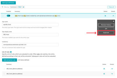

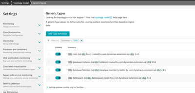

If you have the OOTB extension added to your environment, this topology should already be present.  You can check this by going to Settings: topology model : Generic types. You can see all of your existing types here.
If your custom extension, uses the same metric prefix ("db2") and the same dimension names, your extension will work along side the existing topology. If you have changed the metric prefix or dimension names, you have two options.
First, are you sure the prefix and dimension names need to be different? If you can make them the same, the existing topology will work.
Second, if the your names and prefix need to be unique, you can copy the existing topology and modify the prefix and dimension names to your liking. You can even duplicate the topology within the UI and make your changes there.
This is useful for testing your changes before you commit them to your YAML extension definition.
