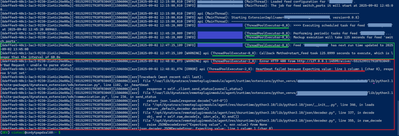

I created a custom Dynatrace Extension using APIs ingesting data from one system into Dynatrace BizEvents, based on a custom scheduler. The execution of data ingestion take few minutes exceeding the regular 60 seconds/1 minute, that is set to execute query method. The executions of the process based on the schedule are successful. Checking the logs from python3.log file, I notice sometimes I am getting an exception from executing the _heartbeat method from the SDK module extension.py
/var/lib/dynatrace/remotepluginmodule/agent/runtime/extensions/python_venvs/custom_<custom_extension_name>_0.0.8/lib/python3.10/site-packages/dynatrace_extension/sdk/extension.py
First, it starts with an error
Error HTTP 400 from http://127.0.0.1:14599/alive/-5515299317920783049: b'Bad Request - unable to parse status
and continues with another
Heartbeat failed because Expecting value: line 1 column 1 (char 0), response b'not set'
As it can be seen in the screenshot the exceptions are triggered by different thread executor ThreadPoolExecutor-0_2, than the one executes the process ThreadPoolExecutor-0_0

Screenshot of logs
Screenshot of the extension.py _heartbeat method

It will be hard to help without the extension code, basically scheduled methods have a status that can be optionally reported, it looks like one of your scheduled methods might not be correctly created our you are using an old version of the SDK with a new OA/AG.
