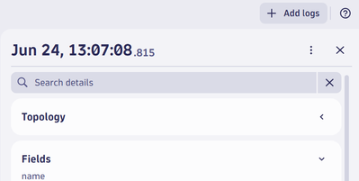

Content section is missing in Logs which was available earlier. Is this related to some settings or permission issues. Any help is much appreciated. Thanks in advance.

Do you see 'content' under the 'Fields' section at all?

Hi, I just see 'Topology' and 'Fields' sections and nothing below that.

I was referring to 'content' in the 'Fields' section, is that showing up?

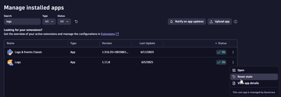

Assuming you have verified that the content field exists on the log event(s) in question (in a Notebook via DQL query, for example), you might try resetting the app state of the Logs app, just in case something has gone wrong with the app's internal rendering logic.
Steps:
