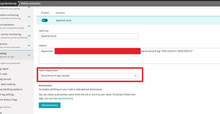

Mizső
Hi @gauravpayghan__
In Classic Log monitoring chose your source and filter to the required contet (Eg. BIND RESULT). Then creating a log metric. You can use these log metrics for vizualization. This is the most simple solution for it.
I hope it helps.
Best regards,
János
Dear Miszo,
We are doing the same thing - like fetch logs then create a metric for the same but it is not reflecting into the data explorer as well as into the Metrics. We are not sure here why it is not reflecting. Even post creating it the the required logs are getting generated - for capture purpose but it's not visible into metrics.
Please help me with the above steps how the created metric will start reflecting into DT.
Dear Mizso,
I am getting the metric in metrics now as well as in data explorer after it fetches sm data it is visible.
Now the requirement is when i pin it to dashboard and shows the records as per respected graph but i want them to be drilled down by clicking it from dashboard only.
For example - i see there's 5 records for bind search in last 10 minutes then if i want to check them directly how it can be possible as i tried directly clicking it via dashboard but it's not opening. I want a solution on this!
